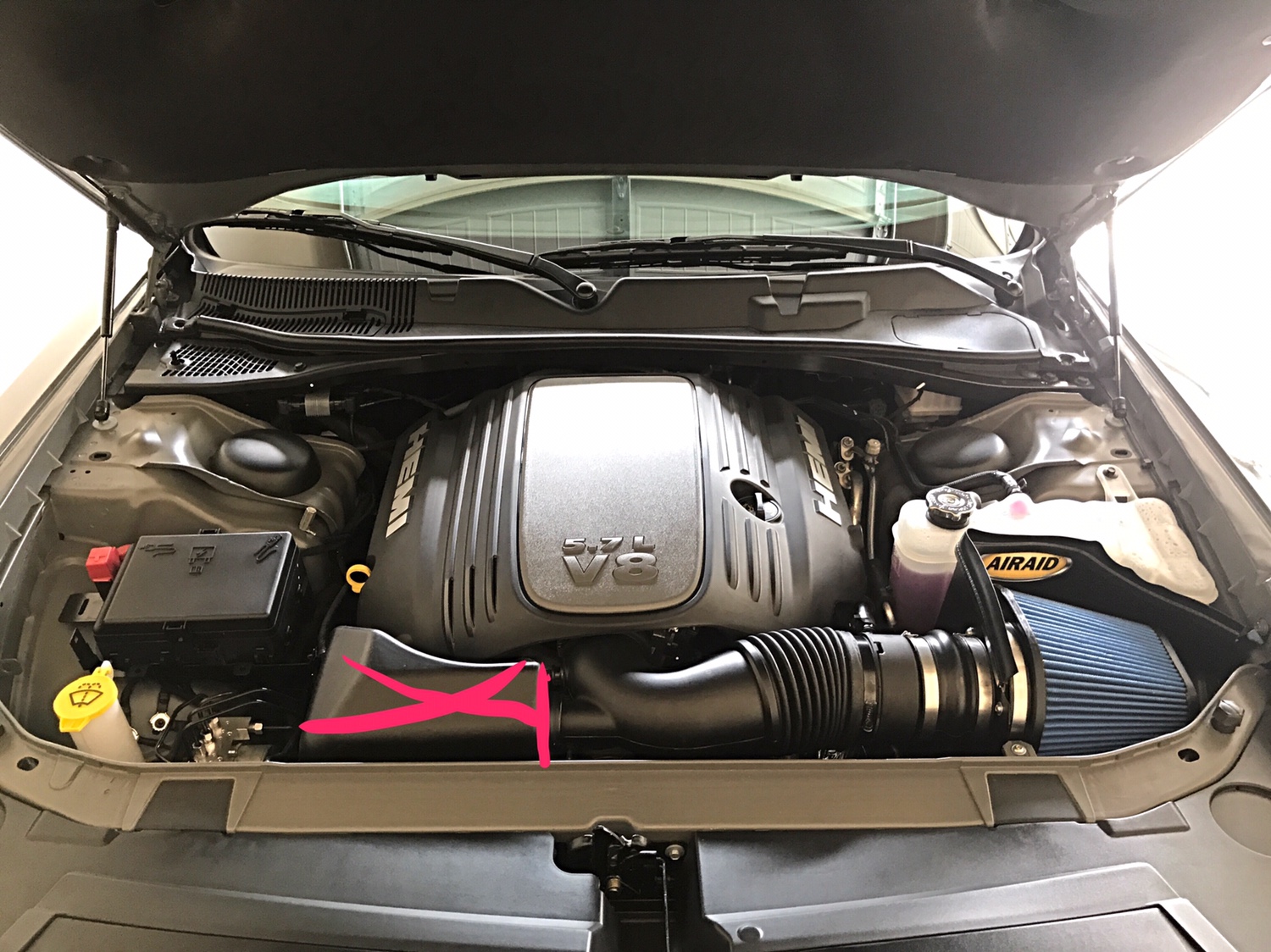

    AiRaid CAI installed. Def an increase in throttle response and get up.

    Very nice! I wonder why the replacement part for that silencer is so expensive though.
  5. IntimidatorRT
    i would just cut that silencer off and put a piece of plastic in its place using JB weld. have seen folks do that, do a good job and you cant tell.

    Are you referring to the resonator on the intake to the left of the throttle body?
  7. IntimidatorRT
    yes, cut that hideous thing off. find some flat plastic to make a plug from and silicone JBweld, that will hold the plug on it it and you will start to hear you intake when you push the gas...

    Looks like the best spot is right here....

  10. IntimidatorRT
    i would cut it off at the curve of the elbow. that way it will look somewhat flush. nothing sticking out that way it creates a smooth airflow. you will have an oval shape to plug up with the so called patch,
