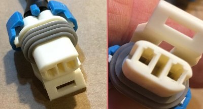

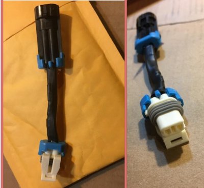

    Received and installed my SkipShift Eliminator cable last night.
    But first, of course, I have to try to figure out what they were doing.
    Tried to ohm out the cable and noticed there were NO PINS in the one end.
    Then checked the pins on the Black Connector that were there.
    36 ohms.
    That is what it take to fool the computer to think the solenoid is still connected.
    I did get the light to come on twice on the way into work today, and was able to smoothly shift into 2nd.
    Soooo much better now :driver:
