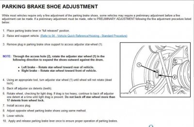

    See the attached.

    Thanks (again) Tom ! Good to know... not su easy to remember which is which though..unless... wait ... I got it....
    Right rotates to front
    and Left rotates to rear...
    RIGHT-FRONT (both 5 letter words)
    LEFT-REAR (both 4 letter words)
    Gotcha! :)
    --- and, as always, that's right/left as you're standing in front of the vehicle, looking at it. (Driver=Right)... right?
