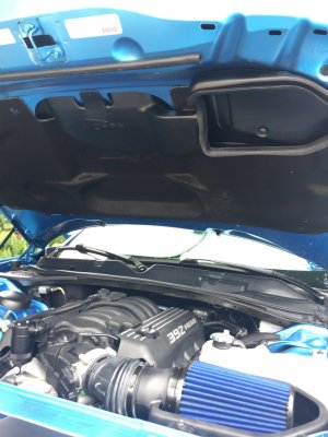

    I opted to install the same Mopar CAI system that comes standard in the Challenger T/A models in my SRT.
    Now the hood scoop is functional and routes the air into the airbag. Plus, it comes with a tube to the headlight.
    Speaking of JLT .... that is their Catch Can that you see in the lower left portion of the picture. It seems to work very well.

    I realize the manufacture must have made provisions, BUT then again, what happens to all the water the hood scoop "scoops" up during a heavy rain; where does all that water go...at least with the hellcat box what water that gets in through the headlight hole drops out the bottom of the air box.
    Just how much did that whole set-up cost, and how easy/hard/long was the install?
  6. Wizard of Iz
    394
    Water hasn't been an issue so far whether in a rain storm or when I wash the car each week. No idea exactly where it goes. The box that comes with this kit is also completely open at the bottom. So it's drawing air from below, from the headlight, and from the hood scoop.
    I bought the kit back in mid-June from Steve White Motors through their ebay site. At that time it was about $600. However, is see that it's now listed on the ebay site as $699.
    Installation was pretty straight forward and probably took about an hour. Maybe a tick longer.

    Thanks...did you use the original under hood liner, or did you get the T/A hood liner along with the CAI...any mods/problems to the liner if you used your original one?
  8. Wizard of Iz
    394
    I kept the stock SRT liner in place with no modifications. The instructions say to remove it or replace it with the T/A liner. Supposedly there’s a concern that leaving the SRT liner will cause the hood to sit a tad high on the left front corner. However mine sits perfectly flush.
    My only scare was that my JLT catch can BARELY clears the duct work.
