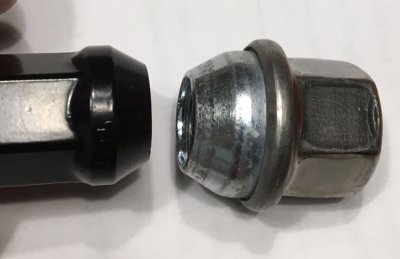

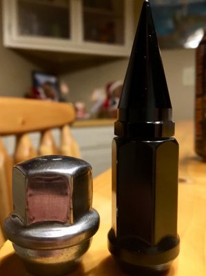

    I bought new lug nuts, because the chrome ones kind of stood out with the blackout package wheels that came on the car. A guy I work with noticed they are more narrow than the original chrome ones, and told me that I cannot use them because, “they’re for aftermarket rims”. They’re the same size, 14mm by 1.5, and the point of contact with the rim should be exactly the same the way I see it. Everything ABOVE the point of contact on the rim is purely cosmetic, right?
    So can I use the black ones or not?

    Looks okay in the pic. similar to the spline type I am using. ( with out the pointy end ).
    Do you have a deep enough socket for them, and if you do don't forget to have something in the car at all times just in case of emergency.

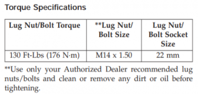

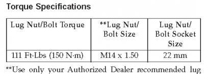

    I'm sure there are many people here that give good information, and I'm not trying to say anyone is wrong, but I'd suggest you check your owners manual for the proper lug nut torque specifications for your car.
    Lug nut torque specs are different depending on the year and trim level.
    Example:
    Owners manual for a 2015 Challenger say 130 Ft-Lbs lug nut torque
    For the same year (2015) Challenger SRT 392 or Hellcat the lug nut torque is 111 Ft-Lbs
