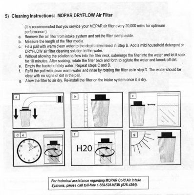

    Here are the instructions for cleaning a dry MOPAR CAI filter (made by AEM).
