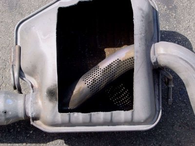

    When my 2009 SRT hit 14,000 miles, it seemed to get noticeably louder and deeper. I think that it was the result of the packing around the resonators deteriorating with age and wear. This caused less noise to be absorbed.
    Here is a cut-away photo of an SRT resonator with the packing removed.
