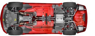

    Here is a good photo showing the plastic engine shield (#2) that has to be removed in order to gain access to the oil filter and drain plug. (Note- This is actually a Charger but it is virtually identical to a Challenger).
