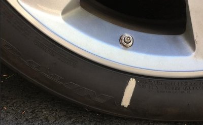

    I marked my tires to watch for slipping on the rim.

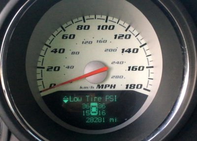

    My track is just over an hr from home and they resync just fine.
    The only problem I have had was with a set of NEW NON-Mopar TPMS on my NEW Nitto G2's.
    Being mine is 2010 and the batteries only last ~5-10 years, I have now that randomly throws a code, then goes away.
    The ones on the Extreme DRAG's are still working fine.
