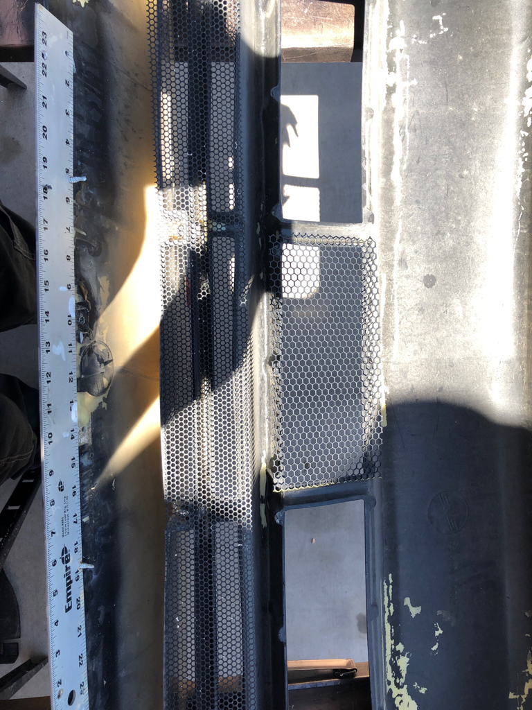

    So 1sr remove front end number cover
    As you see mine has room for a intercooler on bottom as well a cud’s grill feel
    Rotated an removed sms grill inserts
    So the [​IMG]sms mesh was .035 thick an circles

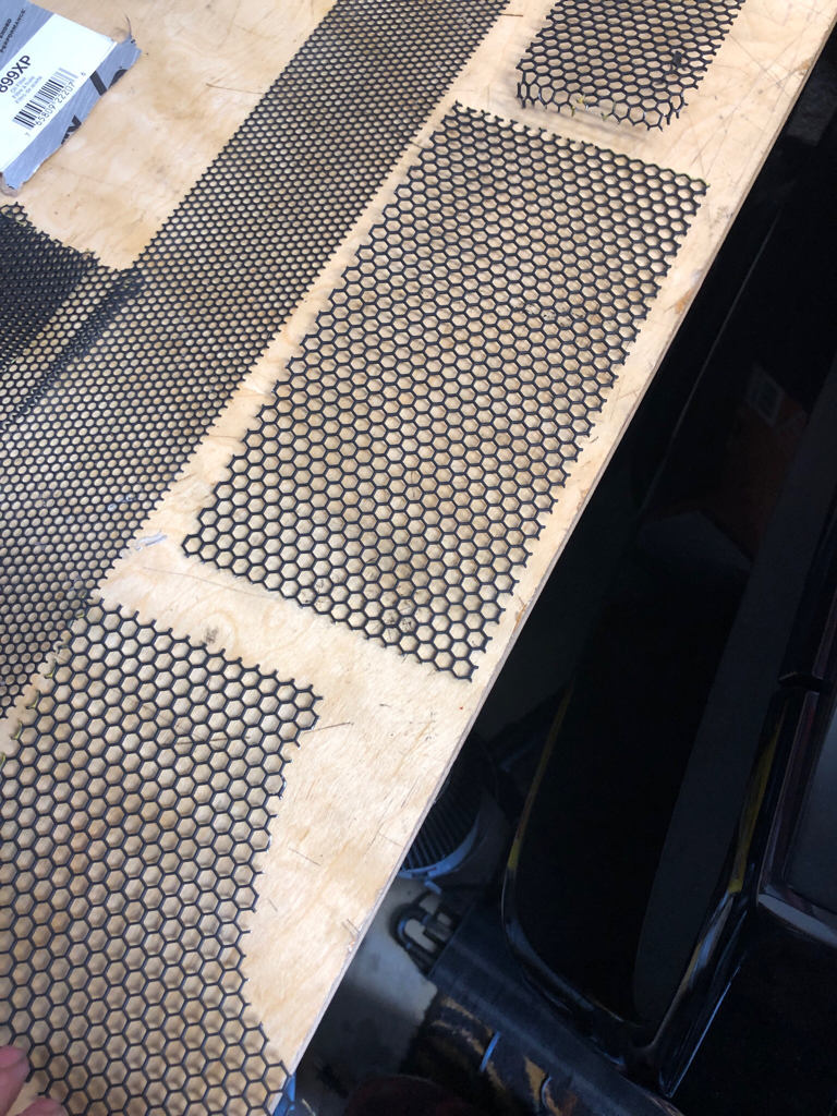

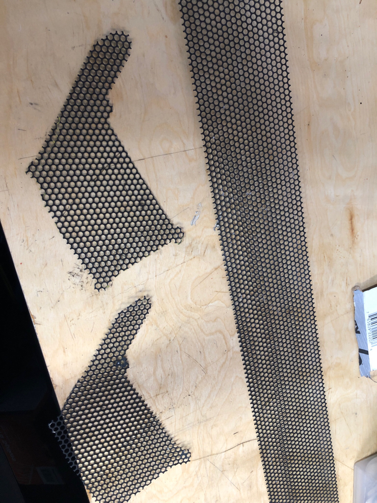

    The new mesh is hex an .067” thick

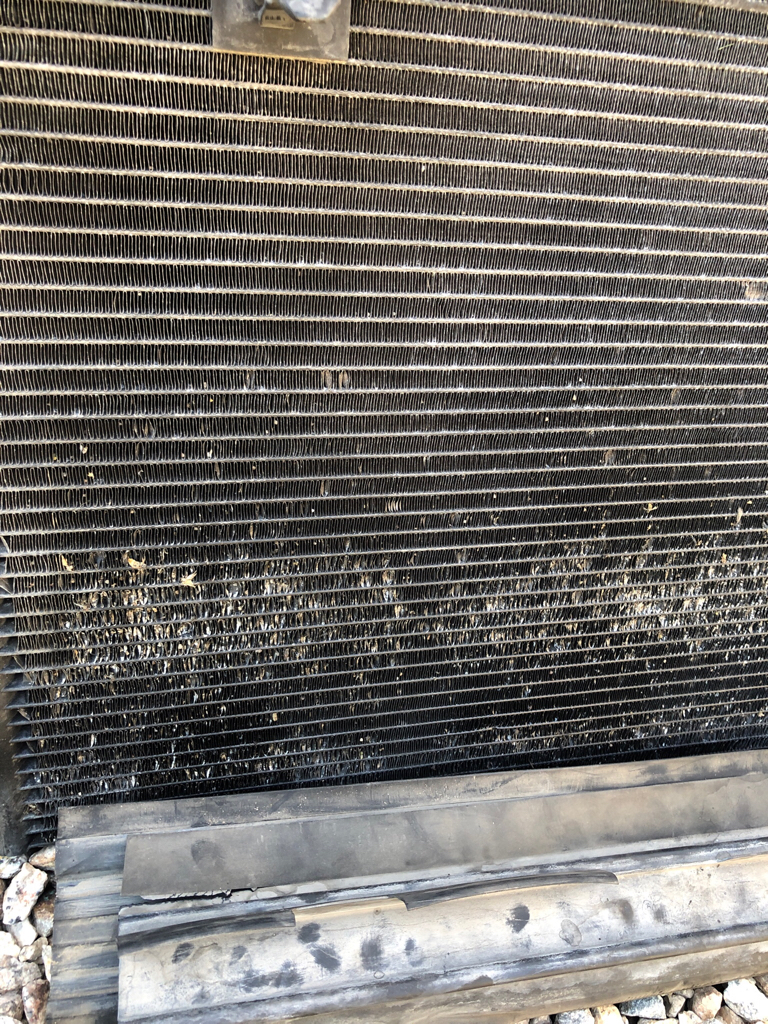

    The sms didn’t use mesh on install for intercooler / ac condenser area causing this
    Now to install more protection
