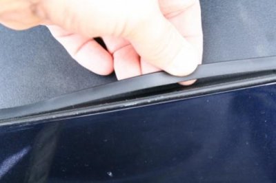

    I have heard that some Challenger owners have encountered a problem with the rubber hood seal.
    If you need to replace it and you are out of warranty, do it yourself. The seal costs $30 and you can get the 11 plastic rivets that hold it in place, from Harbor Freight, for only a few dollars for a box of 20.
    Don't buy them from the dealer. You will be charged $63 ($5.75 each)!
