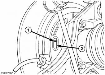

    Need help need to adjust my emergency brake its not holding at our gate at home. Do I need to bring it to the dealer or is it possible to do at home 2011 srt8 392.
    1. Place parking brake lever in full released position.
    2. Raise and support vehicle.
    Diagram Note: 1 - ADJUSTER STAR WHEEL 2 - ACCESS HOLE
    3. Remove plug in parking brake shoe support to access adjuster star-wheel (1).
    NOTE: Through the access hole (2), rotate the adjuster star wheel (1) in the following direction to expand the shoes outward against the drum.
    • Left brake � Rotate star-wheel toward rear of vehicle.
    • Right brake � Rotate star-wheel toward front of vehicle.
    4. Using an appropriate tool, turn adjuster star wheel (1) until wheel will not rotate (dead lock).
    5. Back off adjuster six detents (teeth).
    6. Rotate wheel, checking for light drag. If drag is too heavy, continue to back off adjuster one detent at a time until light drag is present. Do not back off star-wheel more than 17 detents from wheel lock.
    7. Install access plug.
    8. Adjust opposite wheel parking brake shoes using same method.
    9. Lower vehicle.
    10. Apply and release parking brake lever once to ensure proper operation of parking brakes.

  4. Ccrew
    Ccrew Member
    Jan 22, 2015
    Umm, all the Challengers have rear drums for the e-brake. The center section of the rear rotor is a drum for the e-brakes. Regular brakes are 4 discs, but the inside of the rear rotors are machined to work as drums for the ebrake.
