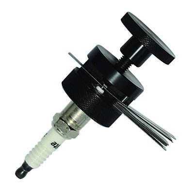

    Those of us involved in modifying BMW's commonly gap / regap iridium plugs (adjusting the ground electrode w/out contacting the center electrode). I've even cleaned the iridium electrodes in a pinch without issue which is 6 times harder and 8 times stronger than platinum. Would not recommend using this type of gapping tool on iridium as you risk pushing the center electrode down into the plug body making it more difficult for a flush / square gapping.

  9. SRT-Tom
    Not necessarily. Just be careful. There are two tools that you can buy on Amazon to properly gap a spark plug. Check out this video.
