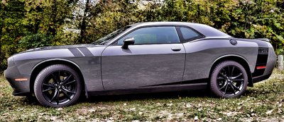

    What's up, Hopslayer! Interesting & unique rear quarter decals on your car. I definitely like the color combo. Have you done your tire upgrade, or are you still doing research & deciding? I'm going to do a similar tire upgrade. I have now, & am going to have mounted & balanced next week 2 Atturo AZ850 275/40/20 tires on my rear wheels. I would also like to put the same size on the front wheels, but I'm not sure yet if I can do that. Might have to do a 255 or 265 on the front. Good luck with everything!

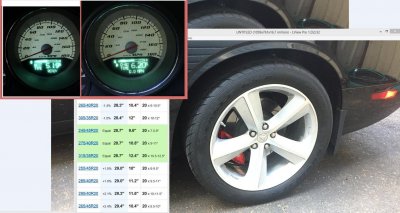

    I replaced the 245/45-20 Goodyear RSA tires on my 2009 SRT with a staggered set of the new Cooper Zeon RS3-G1 ties. I stayed with the 245/45-20 (28.7 inches) size on the front and a wider 275/40-20 (28.7 inches) on the rear (Note- The 275 is the widest tire that you should put on a 9 inch wide wheel. (A 275 requires a 9-11 inch wheel.) Anything wider than a 275 will not wear or perform properly and could be dangerous- see attached diagram- image #2).
    The tire-to-fender gap space doesn't bother me. To shorten the gap, unless you lower the car, you will have to go with a bigger ratio tire, like a 275/50-20 (30.8 inches) or a 275/60-20 (33 inches). There are several problems going this route. First, the larger diameter tires are only suited for crossovers and SUVs and will adversely affect your handling. Secondly, they will not comply with the necessary speed rating that you need for an SRT. Thirdly, they will throw off your speedometer. And, finally, you may lose some torque.
