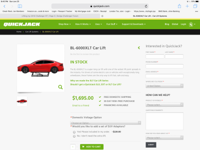

    What did the set run you, is it hand pump or air over hydraulic
  4. 2017 Redline HC
    321
    It is run by its own hydraulic pump. Works very well. Used it the other night to remove my resonators.

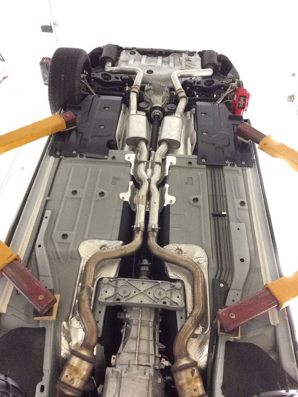

    Here is a photo showing the proper lift points for the Challenger. Don't use the pinch welds.

    Unless you have proper adapters to do so safely....................
