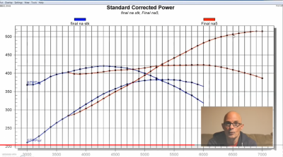

    One thing I learned from Richard Holdener is that adding induction system boost raises the aready-shaped torque/hp curves by a proportion close to boost times normal naturally aspirated pressure.
    The beauty of the centrifugal, to me, is that with their falling torque curves after peak torque when naturally aspirated, engines can continue making more power to whatever redline you choose.
    I will use an actual graph by Richard. First graph is stock motor in blue, Comp Cams cam and ported heads are the red-colored lines.
    Naturally aspirated, the thing gets BETTER power than a hot-rodded system below 4700RPM. However, The much-vaunted Hemi tosses out Big Block Chevrolet numbers of around 515hp at 7000 RPM with only ported aftermarket heads and a cam. Many would be happy right THERE. Eat your hearts out, Brand-X-mongers.

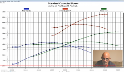

    Then, a centrifugal blower is added. I think Westech limits down-low torque readings to not blow up their dyno, but, anyway, there are the results with red now being the supercharged engine, and green the mod engine with cam and heads, and the blue is still the baseline.
    677hp peak at only around 6500 RPM
    Since this test didn't show us the boost curves, which would have been FANTASTIC for comparison purposes, the torque suffered from the blower at no measured RPM.
    So, about 510 hp to 677 at around 6500RPM, which indicates to me around 4.18PSI of boost EFFECTIVE (14.7 plus 4.18)X510/14.7 equals 677.
    Not a whole hollering heck of a lot of (effective) boost yields a pretty nice increase.
    I would have liked to see RH just leave the truck boringmaster cam in there with unported heads and THEN see how great a contrast the uberlader could have made. But, as you can see, the red lines mirrored the green lines pretty closely, so the boost just spaced the new curve around 150hp higher than the old curve (of the upgrades to heads and cam.)
    So, in short, you just pick your supercharger to find the size you like, then spin it at an RPM ratio that gives you the boost you like at the various RPM's you run.
    If you spin it really fast, you have to use a wasteful blowoff valve to vent the extra pressure so you don't blow your engine with too much power at high RPM, so you can hit the blowoff valve PSI then ride it from, say, 4000 RPM to redline.
    If you carefully select the pulley so that the engine is just hitting its tolerance of extra power at top RPM with NO blowoff valve, you will instead get an ever-rising boost curve that doesn't have an exaggerated upswing at X RPM, then stays planted at some peak torque value all the way to redline.

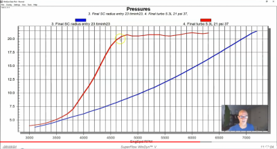

    Note boost curves of centrifugal (blue) versus turbo with electronically-managed boost limit:
    Centrifugals, however, are very simple to tune for, as you just find the pulley that gives you what you want and use a blowoff valve to vent extra pressure at top RPM if needed, but they are not as fuel-efficient. Since you are almost never at top RPM and W.O.T., you can can live with the occasional burst of inefficiency.
