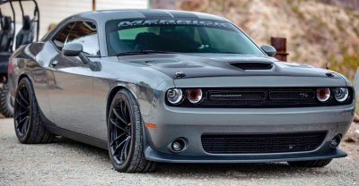

    I decided to go with the exact tires and wheels Todd Merrick runs himself. This is his car.

    That car does look good.
    Looks to be lowered a bit.
    What are those wheels called? Those appear to be the ones that come on the T/A Challenger. I can't find them anywhere.

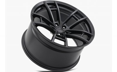

    Merrick Motorsport makes them. Black or bronze. For $1499.00 you get 2 front wheels of 20x9.5 and two 20x11 rears. I’m getting the black ones in a couple weeks.

    Todd said he did use Eibach springs to lower his.

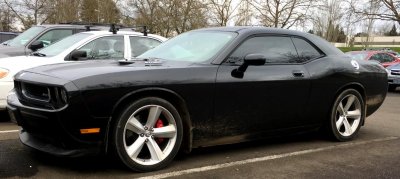

    Here is 265x40x20 on stock SRT 9" front
    and 275x40x20 on 9" rear (With mudflaps)
