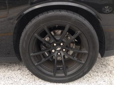

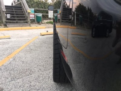

  10. DonnyG
    DonnyG Member
    Jun 17, 2018
    Melbourne, FL
