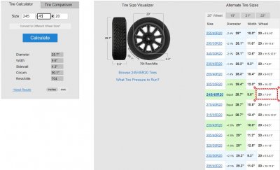

    Thanks for all the replies.. wanted wider rear tires, narrower fronts, sorta old school... love the 8" rims so I will keep researching to find narrower, taller fronts etc.

    Don't go below a 225 with your 8-inch rims. That size tire will not wear or perform properly. Look at the following diagram (image on the right).
