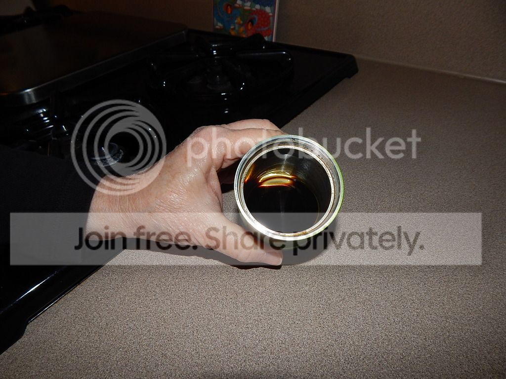

    I installed a catch can on my V6, The Patriot, and would always get a goodly amount of oil, including some sludge like crud in the bottom.
    Out of curiosity, I decided to look at the catch can I installed on my new-used SRT8, even though I wasn't close to changing the oil yet.
    At least a quarter of a cup of oil.
    Good news is ...it was pretty thin, with no clumps.
