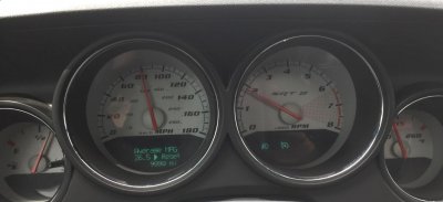

    I really llike my '10 3.5L. It has enough scoot to get me in trouble, gets 28-29 mpg on the highway, and 18-19 in pure stop and go driving. Catch can, K&N air intake, and the 87 octane hemi fever tune. (The last had no effect on MPG, just makes the trans shift a lot better and the throttle more sensitive.)

    26.5 Average MPG!!! WOW
    My average MPG is around 11.5
    The only time it reads more than 20MPG is when I reset it and only drive on the highway.
