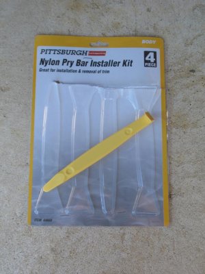

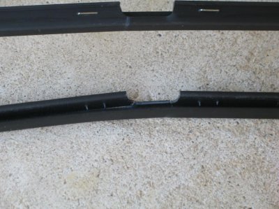

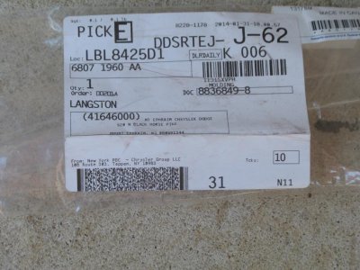

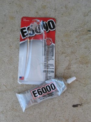

    I found a quicker and much easier way to do this repair.
    As an alternative to the time consuming task of removing the door panel, you can remove the molding by simply prying it in an upward motion, using an interior trim tool ($5.99 a set at Harbor Freight), to pop the small staples. (They come out real easy). Then, you just slide the new molding into place- it is a force fit. Now, since it is not rigidly held in place, it should not crack again. However, if you want to make it more secure (not necessary), you can glue the plastic molding into place with E6000 flexible adhesive. This process only took me about 3 minutes. There is absolutely no need to go to the dealer (unless under warranty), or to take the door panel off!
    The plastic window molding strips only cost about $10 can can be ordered from your dealer's Parts Dept.
    See the following photos:
    1. Original window molding (note small staples).
    2. Parts number for new molding.
    3. Interior trim pry bar (nylon) tool.
    4. E6000 adhesive (can be purchased at any craft store, like Michaels).
