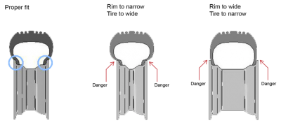

    The SRT Alcoa wheels are forged and have lighter unsprung weight than cast wheels.
    I, however, only recommend a 275/40-20 tire, as the maximum width, on this 9 inch wide wheel. Sure, you can squeeze a 285 or 295 tire on it, but the tire will not wear or perform properly (see diagram #2). Also, it may be dangerous.

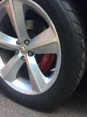

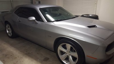

    20190214_205931.jpg Resurrecting a dead post that I started....I did find some OEM ALCOA SRT wheels and put 275/40/R20s on them. They needed the 5mm spacers to fit on a 2016 R/T. So far, they are great!

  5. IntimidatorRT
    757
    why did you need the spacers?. I have seen them on other RT with out the spacers.

  7. AngryLemur
    AngryLemur Member
    13
    Jun 10, 2016
    The installer tried them without the spacers but the front wheels rubbed.
    I'd heard different answers from no spacers to 3mm to 5mm were needed, so I just ordered the 5mm just in case. I may get 3mm to see if they will work.
