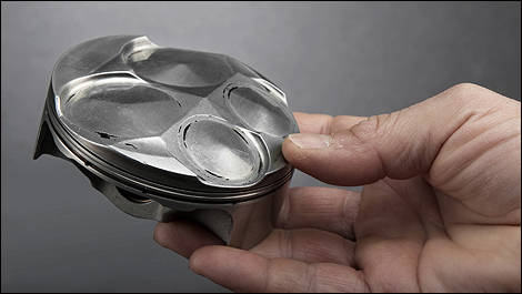

    The thought of designing some pistons that are non-interference fit for the 3.6 comes to mind. Same compression but REALLY deep valve pockets. They'd look like F1 pistons, I think.
    This particular piston has such huge intake valves compared the little exhaust valves, it is not at all indicative of a supercharged engine.
    Observe the very tall areas surrounding the valve pockets though they are called "quench areas" they are also for making sure compression is kept up for maximum power. I have seen them even more extreme than this, with the valve pockets on the edges and even a small tub in the middle, with massively built-up areas all around it, so the valve pockets were quite deep.
