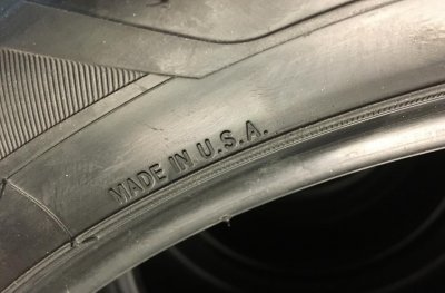

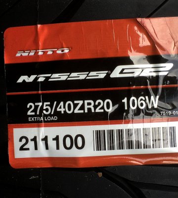

    100%:cheers:
    Even my Nitto are now MADE in USA:
