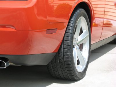

    The widest tire that you fit on a 9" wheel is a 275. Anything wider will not wear or perform properly and may be dangerous. This is what I have on the rear on my 2009 SRT. On the front, I have 245/45-20 tires. This is a great looking "old school" staggered set-up. My car handles better and I have more traction for acceleration.
    Here are two photos of my rear tires.

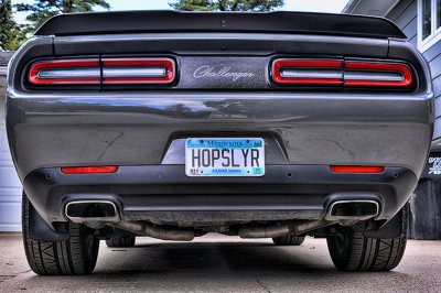

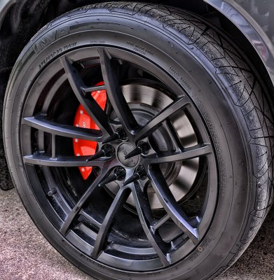

    You could also switch out your wheels and run even wider tires if you like. I have 275/40/20s in front and 315/35/20s in back.

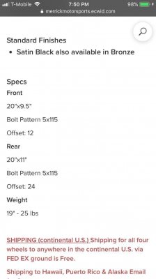

    What offset are you using?
  7. Hopslayer
    258
    These wheels from Merrick Motorsports
