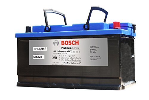

    After 6 years, I finally replaced my OEM battery with a Bosch Platinum battery (H7/L4/94R)- their best. The list price was $219.99 but I got 25% off at Pep Boys (ordered from its web site), plus there was a $10 rebate from Bosch- net cost= $155. A pretty good deal for a premium battery.
    The battery uses absorbed glass mat technology and is supposed to last 2X longer than a conventional battery. It has 800 CCA and 960 CA Reserve- better than the MOPAR battery. It also comes with a free replacement warranty for the first 48 months.
