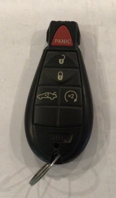

Wait… why does your key fob for a Challenger have two buttons for a rear hatch?
I have a 2010 SRT as well. My key fobs look like this:
The previous owner probably lost the original key fobs and incorrectly bought a replacement designed for a Chrysler/Dodge SUV (i.e., for an Aspen, Journey or Nitro).
You can buy two key fobs, designed for the Challenger, on E-Bay, for only $14.99. Then you can have them programmed by a locksmith.

You have to many variables there, you will drive yourself crazy. Call a locksmith or someone who does e key programming. Maybe they will help over the phone.
