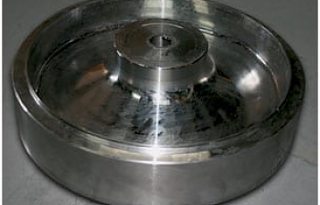

A more expensive forged wheel begins as a solid piece of metal referred to as a “billet.” The billet is then subjected to heat and intense pressure, which compresses the material to form a raw forging. These raw forgings are “forged” into different profiles to allow for the creation of different wheel designs. The raw forgings are then lathe turned and milled to form the final shape and application of the desired wheel. Due to the immense pressure that the billet undergoes during the forging process, the metal is less porous compared to cast wheels and has an interlocking and aligned grain structure. Although this can only be viewed under a microscope, this structure results in improved strength, durability, and resistance to corrosion and oxidation. Due to the more consistent forging, the same structural integrity can be achieved using less material in a forged wheel versus a similarly designed cast wheel.

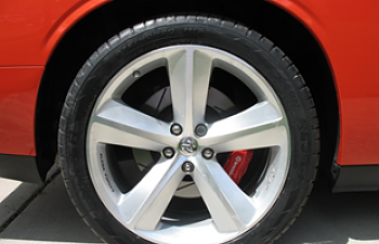

These advantages were readily known to the SRT engineers when they had Alcoa design the retro-inspired five-spoke wheel (20 X 9 inches) on the inaugural 2008 Challenger SRT.
