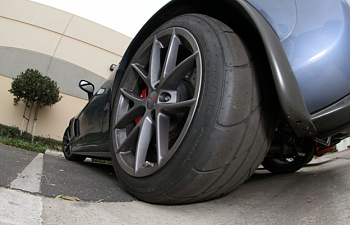

At the track, bias-ply drag tires will produce a lower ET- but only marginally. But the bias-ply tire’s got a problem- it cannot handle things like bumps and corners as well as a drag radial can, which is exactly the sort of stuff you’re probably going to encounter driving to and from the track. In other words, a modern drag radial can give you up to 90% -percent of the traction you need and still get you home safely from the dragstrip without the need for dedicated wheels and tires for the track or a truck and trailer.
There are two kinds of DOT drag tires- radials and bias-ply construction. Drag radials provide a sturdy sidewall for cornering and ride. They also have less rolling resistance than bias-ply tires. The caveat to a drag radial is the compound. They use a special soft compound, which is good for the track, but driving them on the street is going to eat them pretty quick, especially if you enjoy occasional stoplight-to-stoplight runs.
Every manufacturer has their own rubber compounds. The tread compound not only determines the life of the tire, but also the length of the burnout. Regular street tires typically do not like burnouts- the heat makes them greasy and slick, though some high-performance street tires (such as the BFGoodrich Radial TA KDW) like a short little burnout.
Generally, drag radials need less burnout (i.e., should be heated to within 15 degrees of the track temperature), because the special compounds that make them streetable get gummy when they are heated too much. In fact, the ET Street and Street Radial tires only need a short spin to haze the tires as they heat up quickly. This brings the special compounds to the surface, increasing the stickiness of the tire. If you put too much heat in them they start to ball up, kind of like when you rub an adhesive and get little balls of goo. That balling up can actually work against you, slowing down the car in the first 60 feet. In the end, you need to take the manufacturer’s suggestions and experiment with your car.
Another aspect of the rubber compound of a drag radial is its longevity. In order to provide the grip, the compound is considerably softer than a stock or even an ultra-high performance street tire. That grip comes at a cost of lifespan. It all depends on how often you are going to run them. Keeping them properly stored for the majority of the time will add to their life. On average, a set of drag radials, with a mix of track time and highway miles, is between 3,000 and 5,000 miles. Nitto, however, claims that its NT555R tire will last up to 10,000 miles.

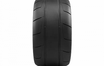

  • Nitto NT555R- Nitto’s NT555R has been a very successful tire, especially in the t model muscle crowd, for its dual purpose street/strip use. With its 100 treadwear and improved water channels, The NT555R can live for around 10,000 miles and combat wet weather situation; it is the longest lasting drag radial.
