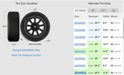

    Contrary to what you will read,
    you can mount 295/40/20's on stock 9" rims
    (I ran ~6k miles on used ones one summer)
    But 275/40/20 are recommended
    I wanted to go 285/40/20's but could not find any with a tread/compound I liked.

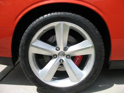

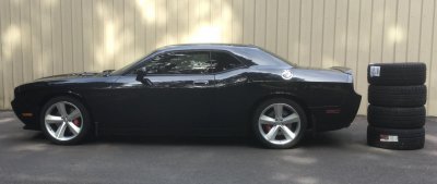

    I installed 275/40-20s on the rear of my 2009 SRT. It has 9-inch wheels and that is the widest tire that will wear and perform properly for this size.
    After a lot of investigation, I bought the Cooper Zeon RS3-G1 ultra high performance all-season tires. They are long-wearing (500 AAA rating), perform great and are reasonably priced. Here are some of the excellent reviews.
    New Tires for my SRT | Dodge Challenger Forum
    FrosbiteScat2021 likes this.

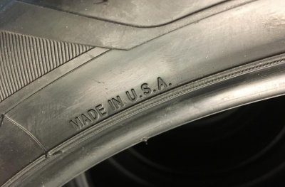

    Plus, the new NITTO's are made in USA :)
  7. FrosbiteScat2021
    FrosbiteScat2021 New Member
    Dec 17, 2021
    Pennsylvania
    I ended up ordering the Coopers per SRT-Tom's advice, they are also made in the USA. We get real winters here so I wanted to stay with all-season performance tires.
