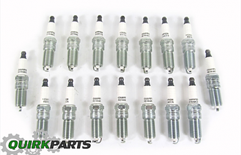

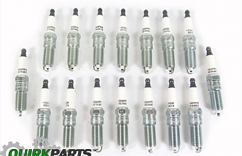

Here are the spark plugs used on the Challenger engines:
3.5L- Champion Copper CC3034. Change at 30,000 miles.
3.6L- Champion Copper CC9407 (CPN-9407). Change at 30,000 miles.
5.7L- Champion Copper CCH570 (SPRE14MCC4). Change at 30,000 miles.
5.7L- Laser Iridium. Change at 100,000 miles (2015 and up).
6.1L- NKG Platinum 4998 (PLZTR5A-13). Change at 100,000 miles.
6.2L- Mopar SP196724AA. Change at 36,000 miles.
6.4L- Champion Platinum CCH3405 (CPN3405). Change at 100,000 miles.
Note: Spark plugs should be torqued to 13 lb/ft.
