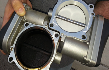

This is mainly due to the fact that the air that comes through your intake system and goes into the combustion chamber won't just be air. It will contain some oil particles which cause the combustion process to be slightly less efficient.
Having oil caked onto your intake valves can cause the following symptoms:

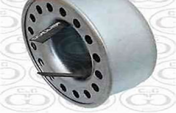

You might ask why do car manufacturers revert this crankcase pressure back into the intake tract? Well, for starters there isn't anywhere safe to revert it to and you can no longer expel it into the atmosphere, like was done on cars built before the mid-60s, with oil vent caps, because it's not environmentally friendly and is not street legal (see photo, below).

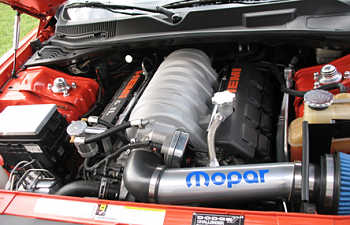

In the first photo below, is a 6.1 Hemi engine with an installed Billet Oil Catch Can (to the right of the fuse box).

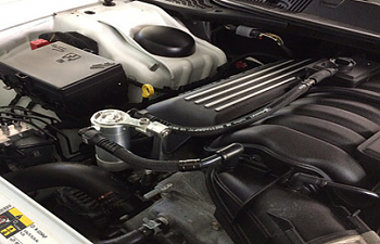

The second photo, below, depicts a catch can installed on a 392 Hemi.

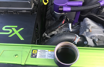

The third photo shows how much blow-by accumulates in the catch can between oil changes and is prevented from being burned by the engine. (Note- Always discard the blow-by and never pour it back into your engine. It is a nasty brew of oil, water, gasoline and acid).
- Knocking
- Pre-ignition
- Loss in power
- Loss in fuel economy
